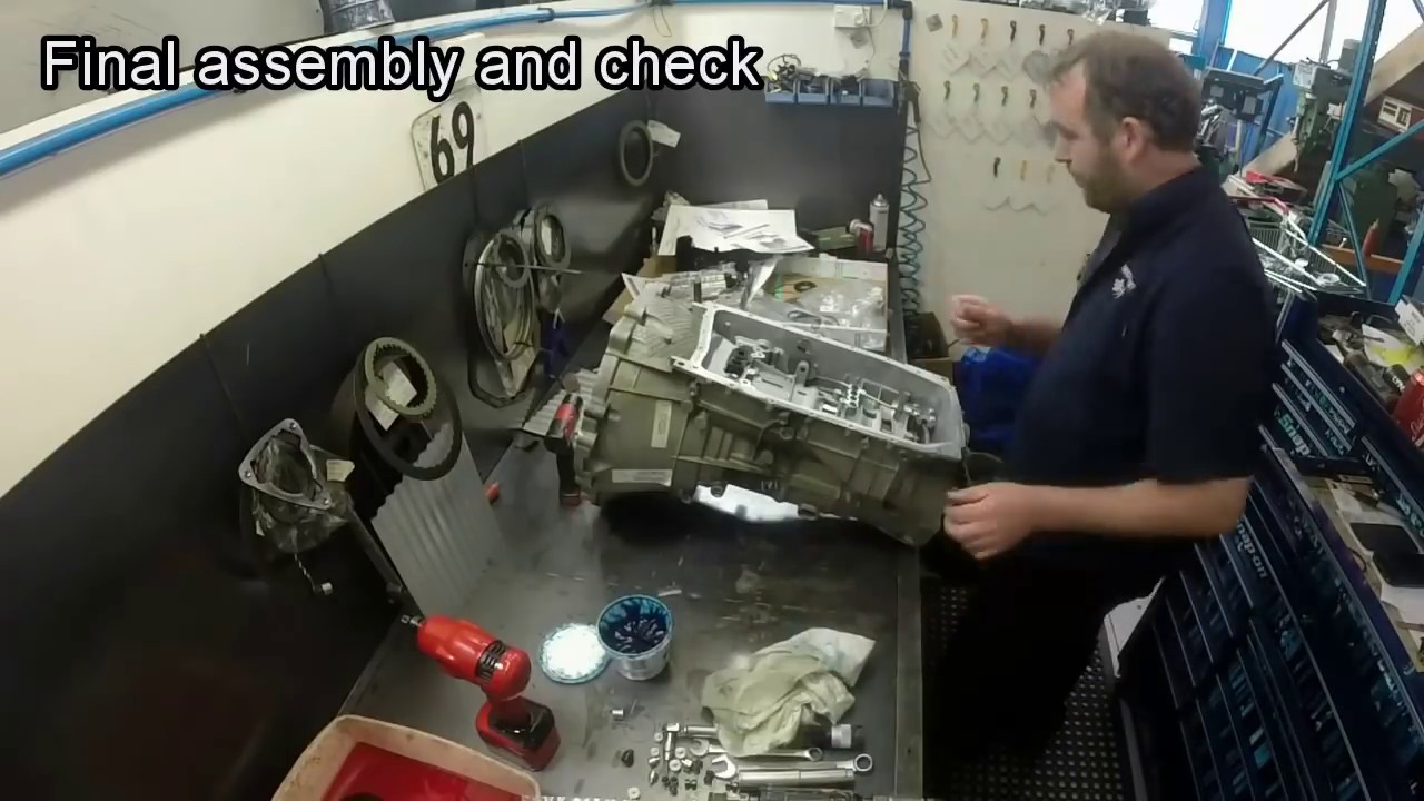

  • 6 HP Beispiel für Instandsetzung:
    ZF 6HP Rebuild
    In this video we rebuild a ZF6HP transmission as fitted to late model Fords and BMWs. We alo fit a sonnax zip kit to improve shift quality.
    www.youtube.com
